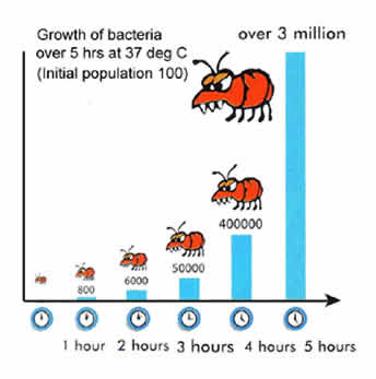

When food is between 5°C and 60°C, harmful bacteria can multiply to levels that may lead to food poisoning. This zone between 5°C and 60°C is often referred to as the temperature danger zone.
